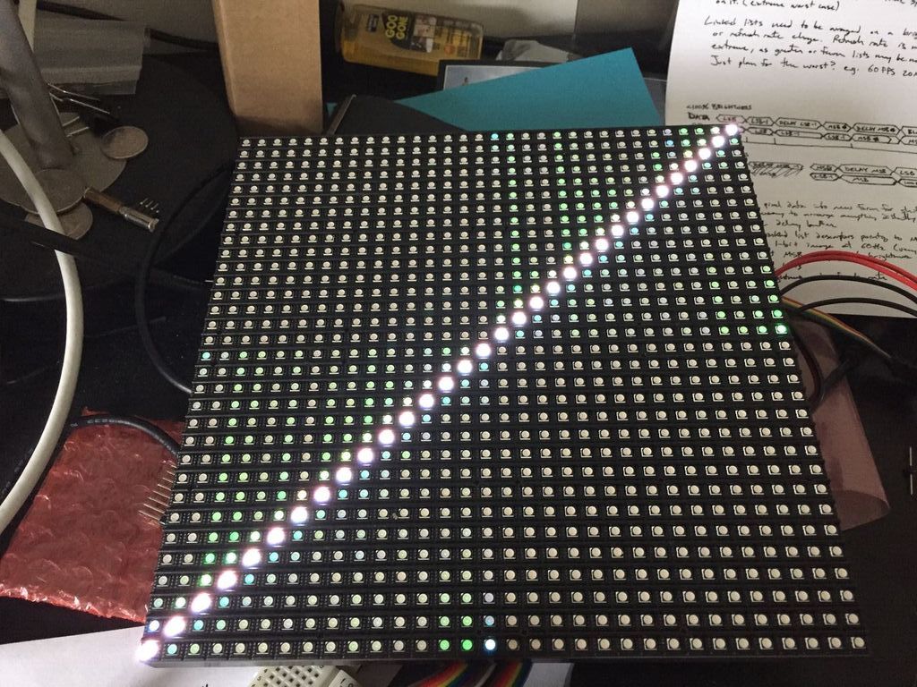

Hi, my name's Louis, and I designed the SmartMatrix Shield for Teensy and wrote the SmartMatrix Library which was originally designed to make it easy to add a HUB75 matrix panel to a Teensy Arduino sketch. I've been wanting to add support for a platform with WiFi capability to the SmartMatrix Library for years, and was excited to find this forum thread and example code that makes it possible using the ESP32.
The way of refreshing the panels in Sprite_tm's example code makes a lot of sense for the ESP32's architecture, but highlights some problems with these HUB75 panels. After charging up a row by setting the address lines and then releasing that row by moving to a new row, the row drivers needs to be discharged through the column drivers and LEDs. This lights up pixels that may not have been intended to be lit on the current row. This shows up every time the address line changes, and the method of refreshing the panels in the example code is switching rows as frequently as possible, leading to the maximum number of ghost pixels showing up.
Here's a photo of the example code refreshing a panel with CLK set to 20MHz, and a test pattern displayed. The diagonal line maximizes the ghost pixels as each row has only a single unique column lit, forcing previous rows to discharge through a pixel that wasn't intended to be lit.

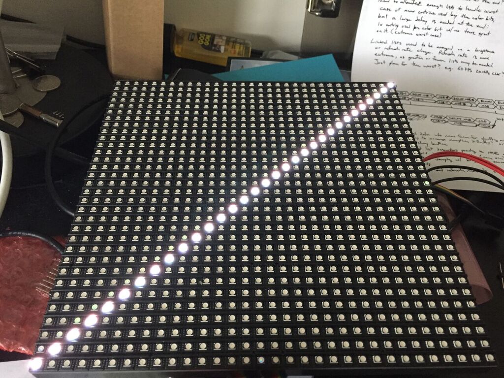

The best solution - that doesn't involve modifying the matrix panels themselves - seems to be to minimize the number of row switches when refreshing, so shift out all the color bits for a given row at once, before moving to the next row.

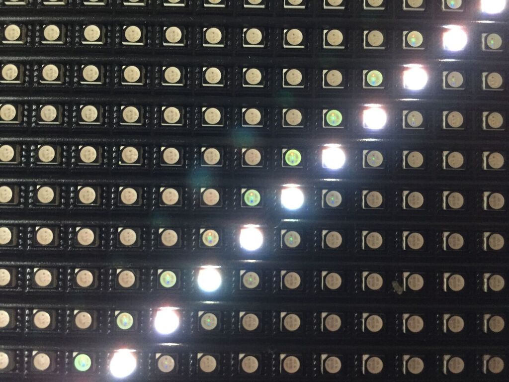

I modified the example code to do just that. Here's the same panel and test pattern refreshed with CLK set to 20MHz.
2018-03-28 12.49.06_preview.jpeg (198.56 KiB) Viewed 55924 times
It looks much better, at a distance you may not even notice the ghost pixels. They are still there, but dimmer and limited to the row above each lit column. (There's another even dimmer green pixel lit below the row, but I think this is an unrelated bug I haven't yet tracked down)
