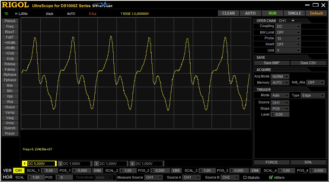

short and dirty, get the 50/51MHz,
edit: see next post, the 50/51 comes from echo line by Rmii board with 50MHz osc on board.
now need to be filter, sharper ..

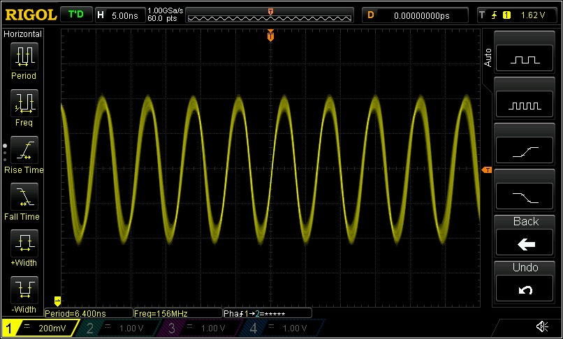

Had measured the loop with 50 MHz RMII on the module on the meter
And received the 50 therefore and with Jitter ..

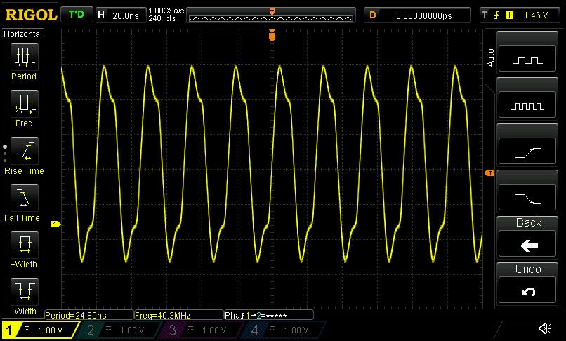

Now I have only the esp32 on osz and try a few settings
But I always get only 40 MHz.
usually 40
40 MHz * (0 + 4 ) / ( 2 * (0 + 2 ) = 40 MHz
rtc_plla_ena(1, 0, 0, 0, 0);
but get 40 MHz

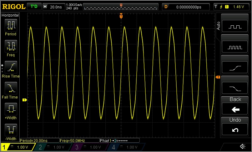

bingo
50 MHz
figured it out

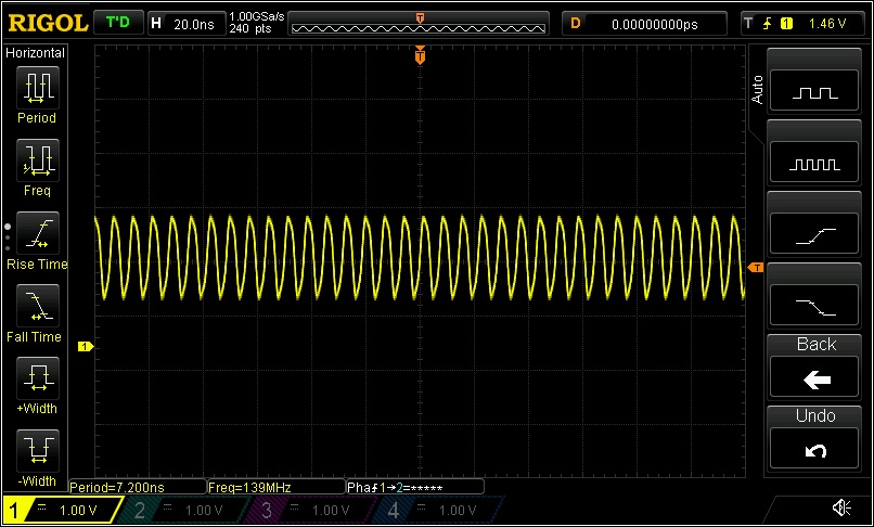

btw: 139MHz
156 MHz ( 160 MHz )
