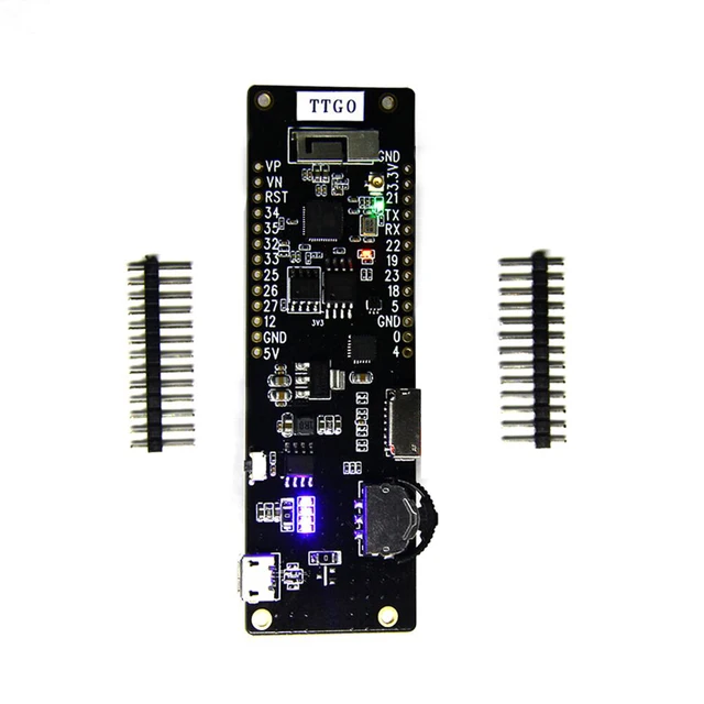

I used to work on similar project involving agricultural data. You could buy this:
https://www.aliexpress.com/item/New-TTG ... 80565.html
and connect it to 2W-5W solar panel charging lipo battery during day. It works great even now. It just measures weight and temperature and sends data over wifi.
