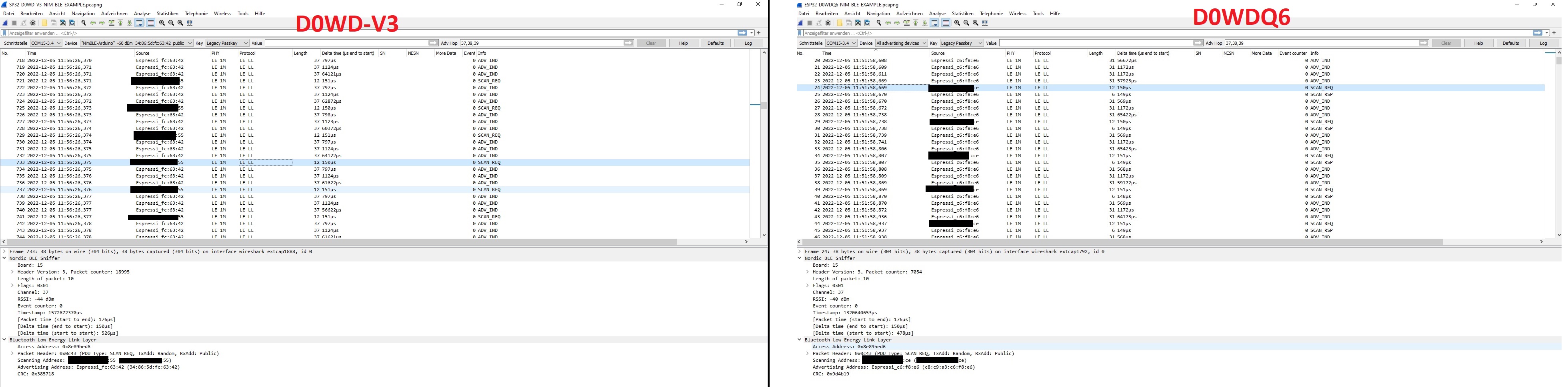

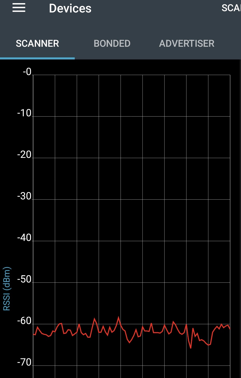

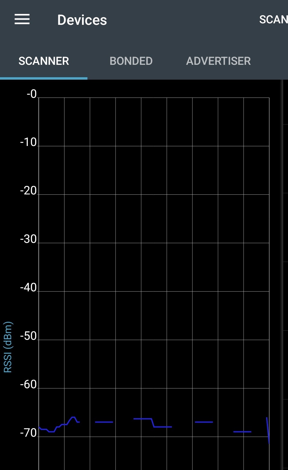

Ok! To be much more concrete:
I tried different example codes of BLE from Arduino (especially) BLE_server and BLE_server_multiconnect (from Arduino BLE lib) and also the NimBLE library with examples (NimBLE_Server and Nimble_Server_secure).
-> i tested 4x ESP32-D0WDQ6 (revision 1) chips with the same code - examples worked as expected
-> i tested 3x ESP32-D0WD-V3 chip (revision 3) - none of them worked with the examples, sporadically advertisments (only very rarely a connection was possible)
In the nRF Connect App i see strange RSSI interruptions of ESP32-D0WD-V3 chip during it's BLE advertisments. The RSSI value of ESP32-D0WDQ6 is not interrupted during it's BLE advertisisments. Please see attached pics. Used example code for the two chips was the Arduino NimBLE_Server.
With nrf ble sniffer i made a capture of the two chips with running arduino NimBLE_Server example. Please see attached wireshark screenshos. Here it seems that something is going wrong for the SCAN_RSP packet on ESP32-D0WD-V3 (left side of picture). (The SCAN_REQ comes from the nordic ble sniffer.) The SCAN_RSP on ESP32-D0WDQ6 looks good (right side of pic).

Same problem here. V1 works well. With V2 advertisement packets looks good but I don't see any scan responses going out in response to the scan requests from the test device. This makes the V3 invisible to the Bleak python app that tries to talk with it.
