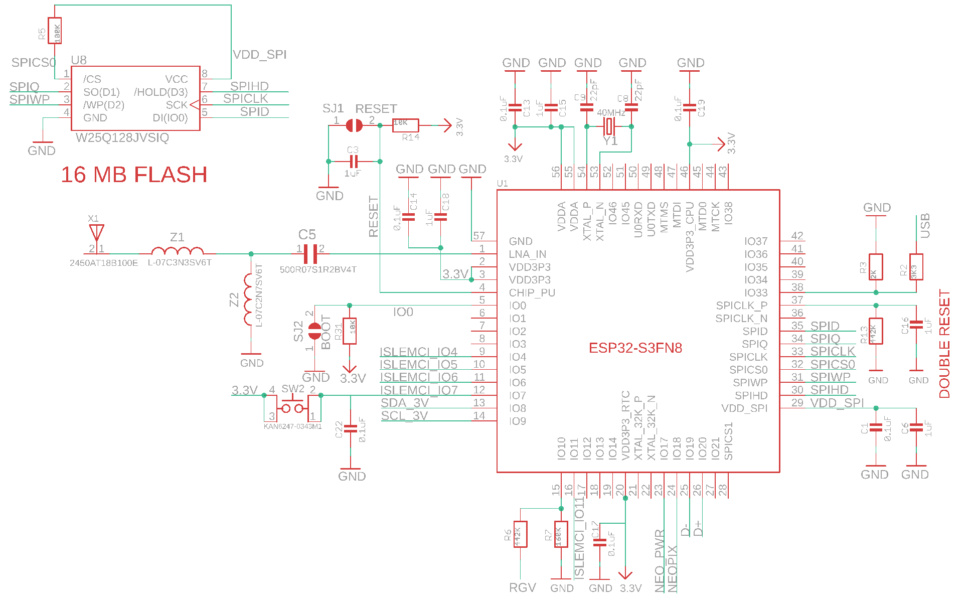

The board is custom designed made by us. We have 8 MB of flash inside the ESP32-S3 (FN8 Model) chip. We also have 16 MB of flash (WINBOND W25Q128JVSIQ) on the board next to ESP32-S3.

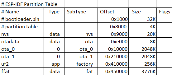

Our partition table is attached.
Our schematic is attached.

- Posts: 9052
Re: ESP32-S3 Bootloop Problem
The -FN8 version of the ESP32S3 already has 8MiB of (octal-spi) flash inside; that's likely interfering with the flash you already installed. Desolder your external flash chip and everything will likely work.
- Posts: 6
- Joined: Fri Feb 03, 2023 11:50 am
Yeeeeesssssssss. This is it. 17 days!!! And finally we did it. Thank you very much ESP_Sprite. I really appreciate what you are doing. If you come to Istanbul, find me +90 5323918755.
