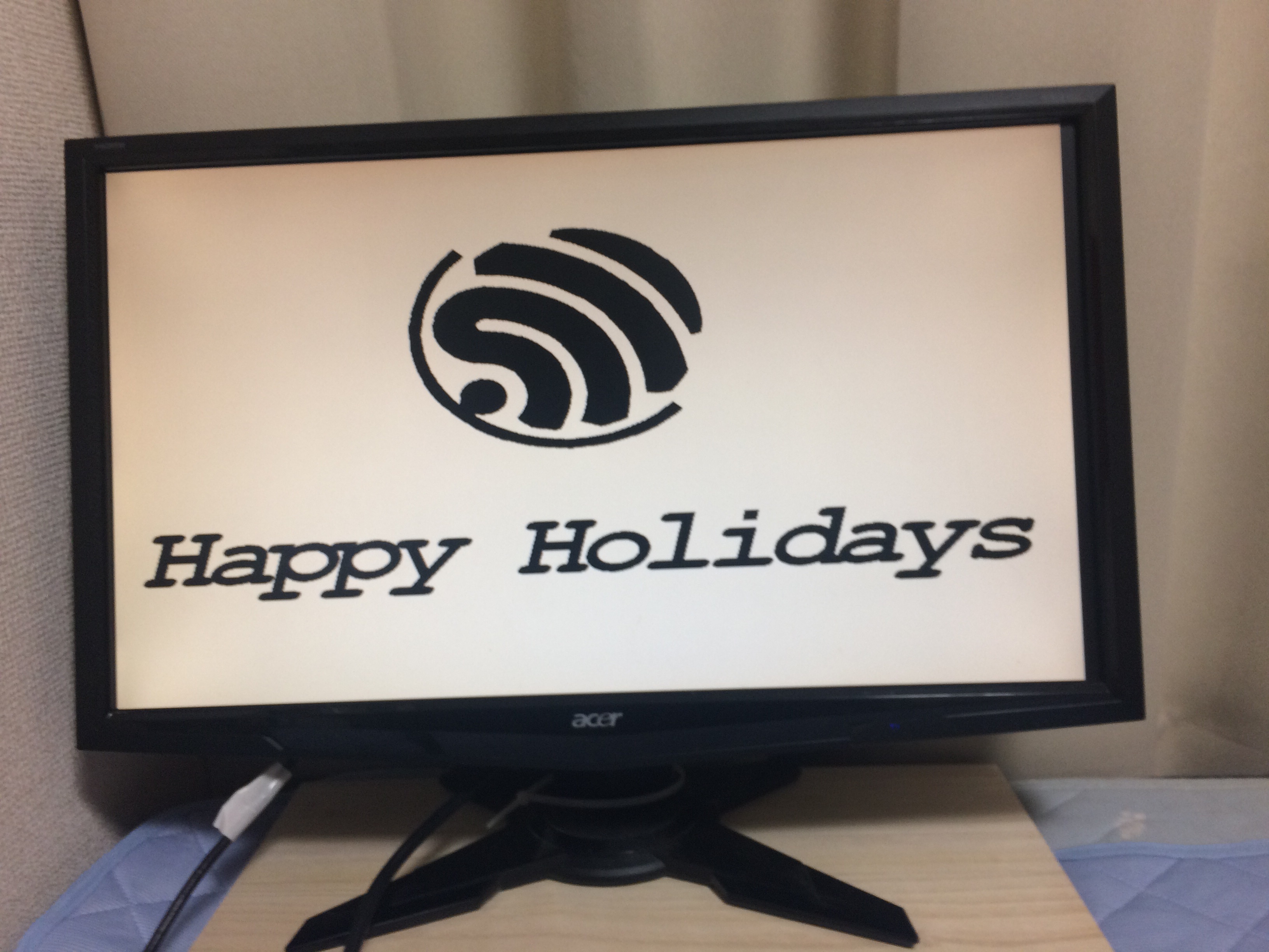

Thanks for the info, ESP_Sprite and the engineer from digital team. SPI_DMA_CONF_REG.SPI_DMA_CONTINUE (spi_dev_t::dma_conf.dma_continue) works like a charm!
Since it's late-night in my timezone, I'll write wrap-up about this experiment with source code tomorrow.
Anyway, here's a photo which doesn't prove anything but celebrate my experiment

Hi, I attached source code of my VGA experiment. Setup procedure is
(1) Check GpioPins in main/vga_experiment.cpp. You should define and connect 3 GPIO pins for VGA: V-Sync, H-Sync, Video (single pin).
(2) Run make menuconfig for setup.
(3) Run make -j flash monitor for build & run.
Hope someone find fun and better approach.
So far, this code has some major problems.
(1) SPI DMA clock keep delaying for each few minutes.
V-Sync and H-Sync signal generation is rock-solid. It doesn't slip any nano seconds at least 4 hours.
But relative timing between H-Sync and SPI DMA have problem. In my experiment, DMA's timing is delayed (I mean H-Sync backporch becomes longer, frontporch becomes shorter) for each 1 to 3 minutes (I still don't measure it). And length of delay is always increased 200..220 ns at once (maybe 8 to 9 DMA cycles).
(2) More accurate, reliable initialize procedure is needed.
Final part of main/vga_exeriment.cpp : myvga_init() uses empty for() loop to make H-Sync backporch (margin between H-Sync pulse and video signal). It's absolutely fragile. But if esp-idf has API which can wait precisely, I'd like to use it.
Also I'm not sure portDISABLE_INTERRRUPTS() prevent all interrupts or not.
(3) Check it reasonably conform VGA.
My display show something. But perhaps another display doesn't sync the signal. I'm not confident that my code outputs good enough VGA signal or not.
Anyway, that's it for today. Thanks again for your advices!
