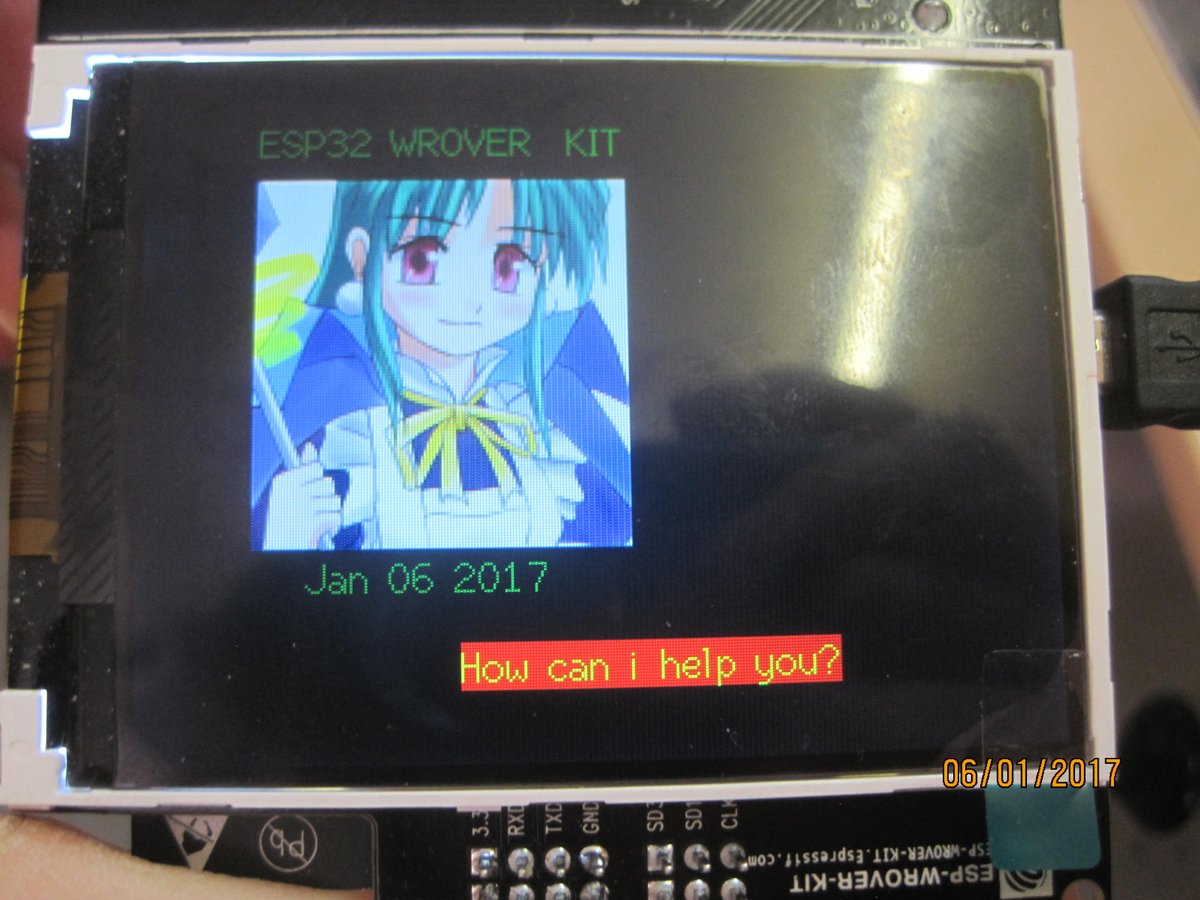

I want to be as closed as possible to Krzysztofs
great
https://github.com/krzychb/esp32-cam-demo#connect ;
Only want to port the idf-project to Arduino-IDE without freeRTOS.
The famous DMA-transfer is good to look at for further use.
I think i would do the reading out of the GRAM-Display with this.
With a function "snapshoot" (triggered by touch) that contents will be saved at an SD-card.
At the moment i struggle with one line in the code:
timer_conf.bit_num = 3;
in function:
static void enable_out_clock();
I've to learn more about PERIPH_LEDC_MODULE..

Re: Camera
This was the right hint.
I've changed it to :
timer_conf.bit_num = LEDC_TIMER_13_BIT;
and it compiled.
13-bit deep timer, i don't know, but seems to be right?

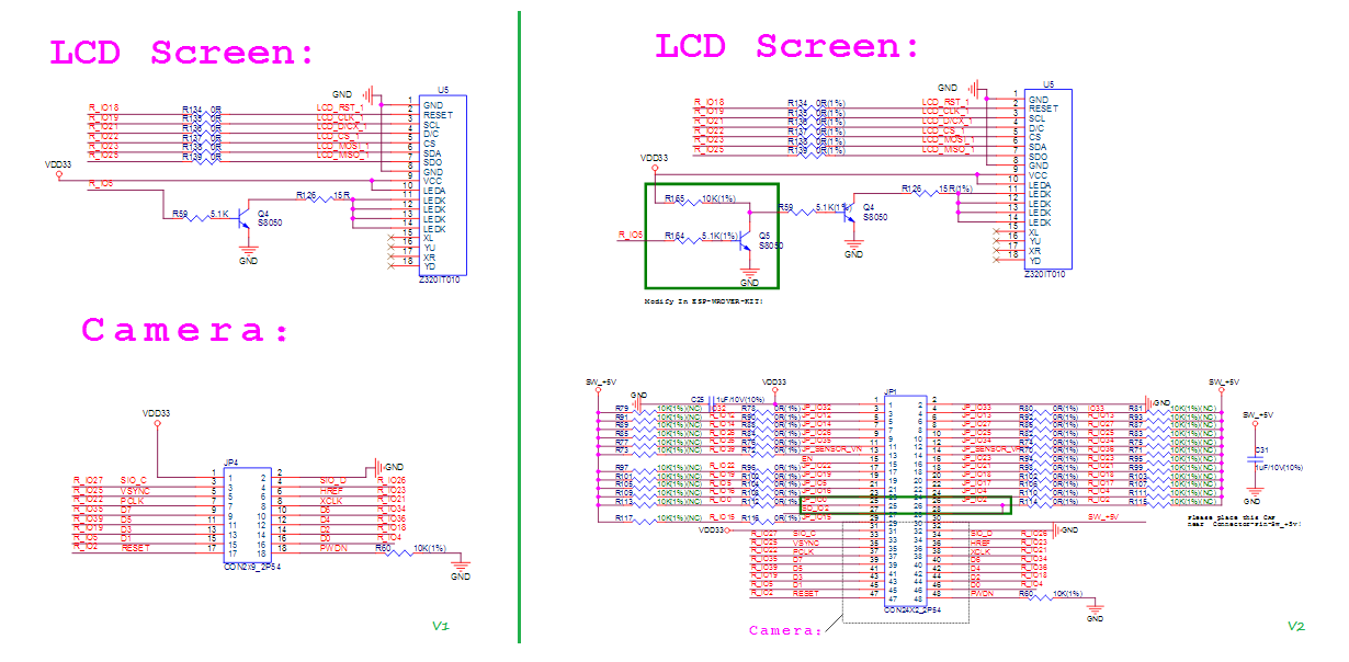

i build with DevKitC/Nano32 again and the OV7670, prinzipal works now.erhardd wrote: You can take GPIO32..39 as Input. That's right!
But I need an 8-bit Output for the ILI9325 (ucg-lib) and the pseudo-Input for CAM at the same pins..
p.s.:
Have you found the missing Vsync ?
Use you the VSPI for your ILI9341?
At Prgr.3 I display the contents of the SD-card(not included-->see http://esp32.com/viewtopic.php?f=19&t=702).
It is slow in VSPI (but right for slideshow)..
must study the shematic from wRover kit V2,
there was a change on few pins,
one thing ,more, the QV7670 need pullups on SCL and RST must be pulled up ( 3.3 ) , the PWRDWN must pulled down ( GND ).
then OV7670 is talking SCCB, this result comes from "long night" testing,
for flashing with OV7670, break short RST from 3.3
http://esp32.com/viewtopic.php?f=12&t=344
btw the lcd D/C is same like Xclk.
rudi
