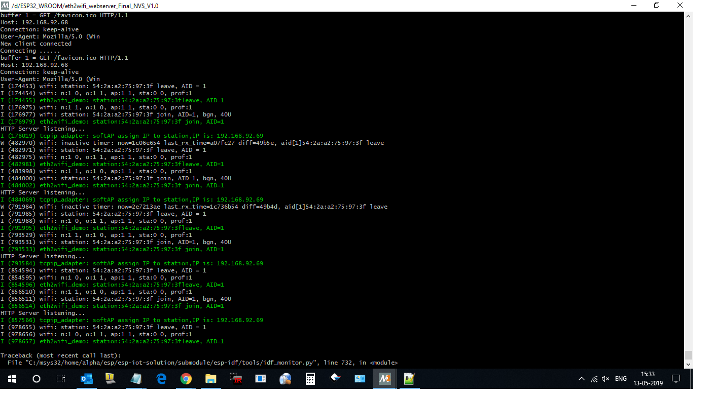

I am using ESP32 in AP+STA mode for a web server application, I scan available AP's using STA mode, Create network using Soft AP, and run a webpage on IP provided by Soft AP. I am getting same message as Ritesh. I tried to reconnect but failed. I can see station connected, soft AP assigns IP address also but if I ping the device it fails. It connects only after resetting device. Need to know reason why soft AP losses connection?? How to reconnect it??
Thank you in advance.
That is because STA is going to scan all channels for configured router at that time AP is also going to switch with that channel accordingly. So that you will get AP of ESP32 Device to be restarted with that duration.
Might be ESP32 SDK Developer can also provide few details for this.
