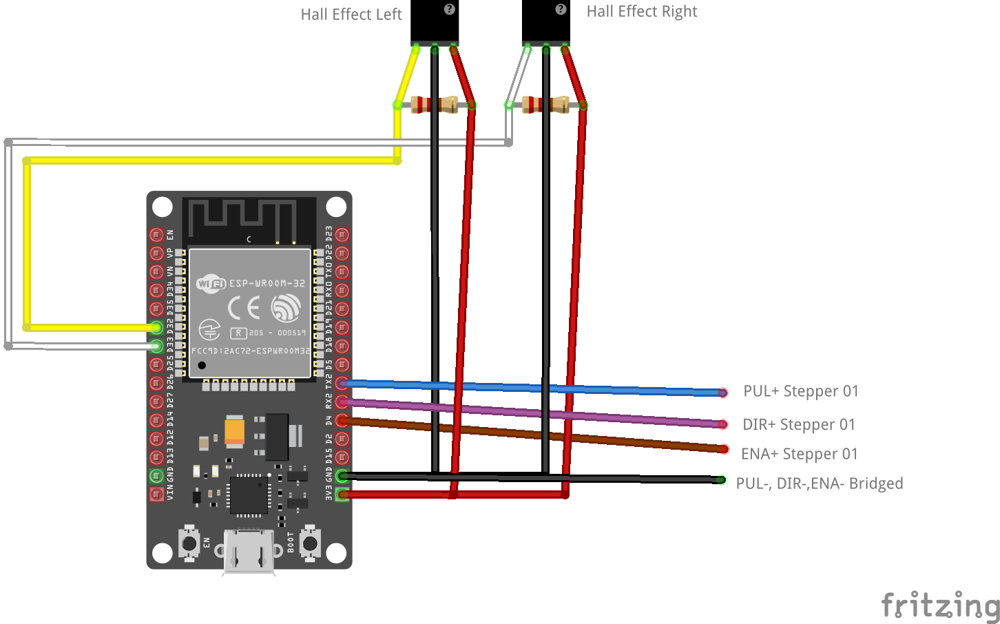

I just started using the ESP32 and having issues using interrupt pins. All of this is working on an Arduino board but I would like to switch over to the ESP32. I have 2 Hall Effect switches connected to pins 32 and 33. The Stepper motor is on pins 16 (DIR), 17 (PUL) and 4 (ENA)
The Stepper motor works when I test it with a simple sketch (Nema 42 using a Microstep Driver DM556S). The Hall Effect Switches works when I test them with a simple sketch, but if I power on the stepper motor's power supply the interrupts immediately gets triggered. As a newby this is really confusing me. Attached is an image of the layout and the code will follow.
With the power to the stepper motor OFF and running the sketch I get "Triggered" when the magnet moves over the Hall Effect Switches. The moment I turn on the power to the stepper motor I just get an endless loop of "Triggered" in the serial monitor.

Do you have an oscilloscope you can connect to the Hall sensor output pins? Sounds like you're getting interference from the steppers on those lines.

Unfortunately not... and doing this as a hobby I admit I don't always know what I am doing. I also think it is interference...
I have also tried a simple digital pin sketch that will display 0 or 1 for the Hall Effect switch, not using interrupts, just using the basic loop function and a delay(200).
The result is that it will display 0 for a while, then display 1, then display 0, then display 1 - all this without a magnet, so it does look like it is interference which I don't get on the Arduino boards. But I also know the Arduino boards has some extra resistors etc built onto the board which the esp32 doesn't have.
I think my question is maybe what can I add to reduce this interference? :D

UPDATE - I placed a 104 Ceramic capacitor over the Gnd and VIN wires of the Hall Effect Switch and this is giving better results. It seems like it is more stable and I can use the switches for now. Not sure if this is the correct solution, but it's working for now.
