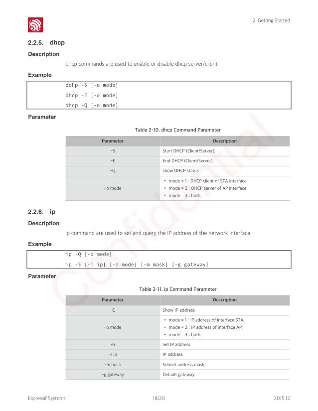

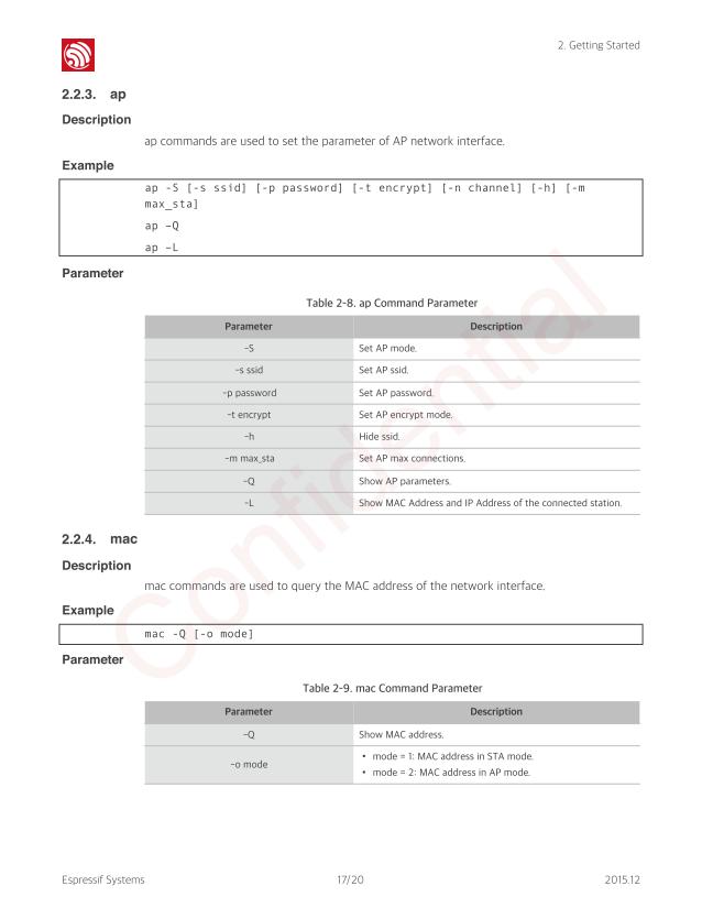

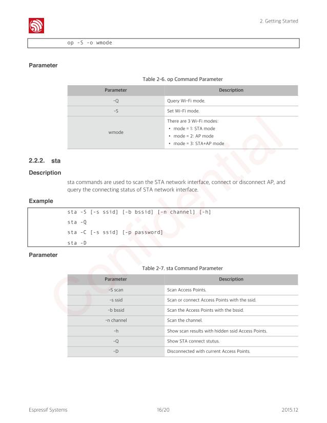

Really appreciated. but do these commands work? Whenever I set STA or AP mode, it seems the WiFi connection is NOT ok. Could you show me this correct commands to let me do wifi connection at SAP or STA mode?
1. STA
sta -S --> scan is OK. but sta -s <my_ap> doesn't work. I have set with op -S -o 1 to set to sta mode.
:>op -Q
+CURMODE:1
+MODE:OK
:>sta -s kkktpl
:>sta -Q
+JAP:DISCONNECTED
2. AP mode
same commands.
:>op -Q
+CURMODE:2
+MODE:OK
:>ap -S
+SAP:OK
:>ap -Q
+APCONFIG:empty_string,empty_string,11,0,0,4,100
:>ap -s test_ap
+AP:ERROR
:>ap -s test_esp -p 12345678 -t 1 -n 6
+AP:ERROR
:>ap -Q

hi
you want -SET
you forget to write -S after ap
-s is parameter for ssid
be sure you use big letter and small letter ( -S -s )
other example:
ssid: FIREBOOST
pass: not4upublic
encrypt: 3
channel: 5
ap -S -s FIREBOOST -p not4upublic -t 3 -n 5
and querry
ap -Q
// STATION and SOFTAP Mode
op -S -o 3
// check mode
op -Q
// SCAN AP
sta -S
// Status of Station ( JAP connected or disconnected )
sta -Q
// connect to a JAP
sta -C -s YOURSSID -p YOURPASSWORD
// Disconnect from connected JAP
sta -D
be sure you use big letter if document use big letter
it is differen if you write
op -q
// or
op -Q
..and so on..
hope this helps
in the posted docu all works fine
