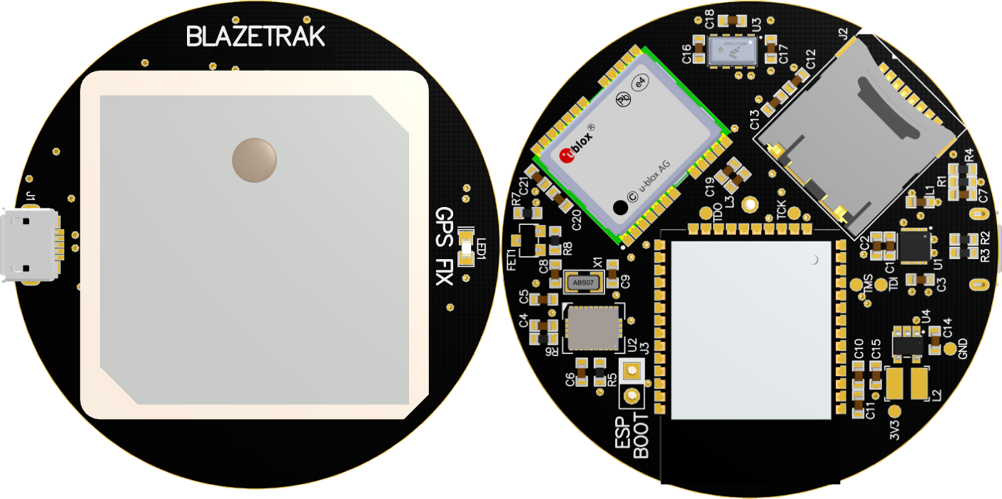

- First prototype received last week
- prototype.jpg (121.23 KiB) Viewed 64305 times
- Initial PCB design
- design.png (448.39 KiB) Viewed 64305 times

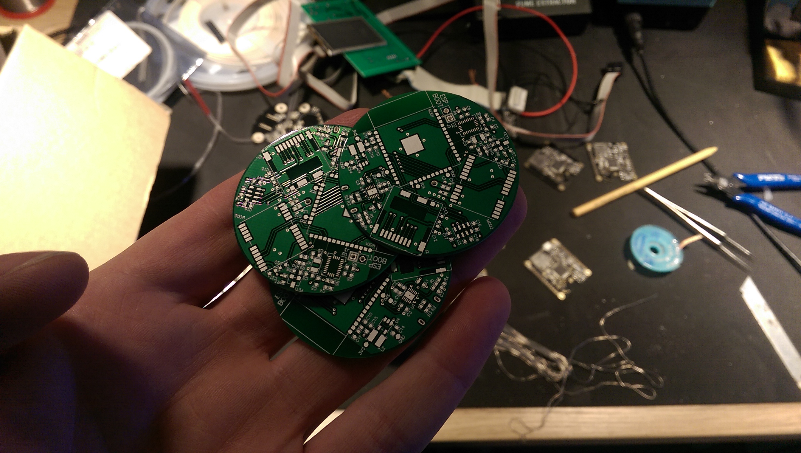

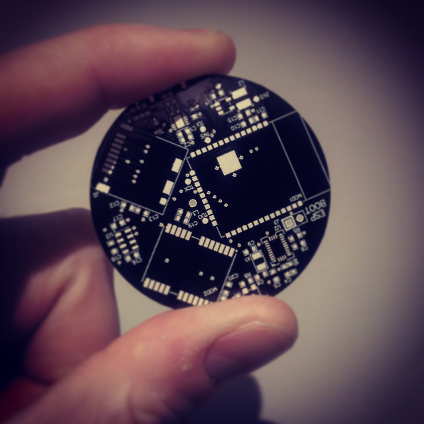

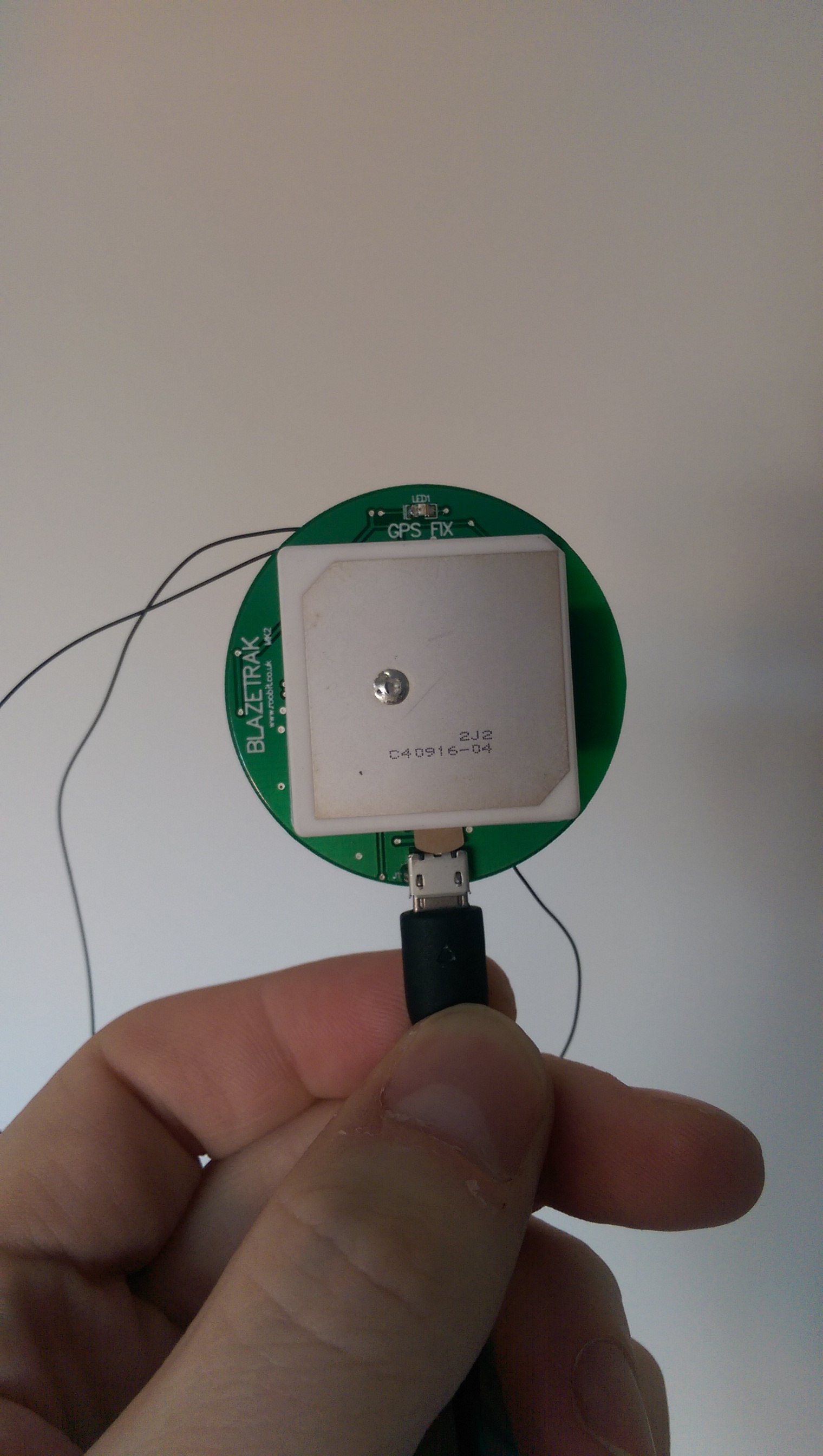

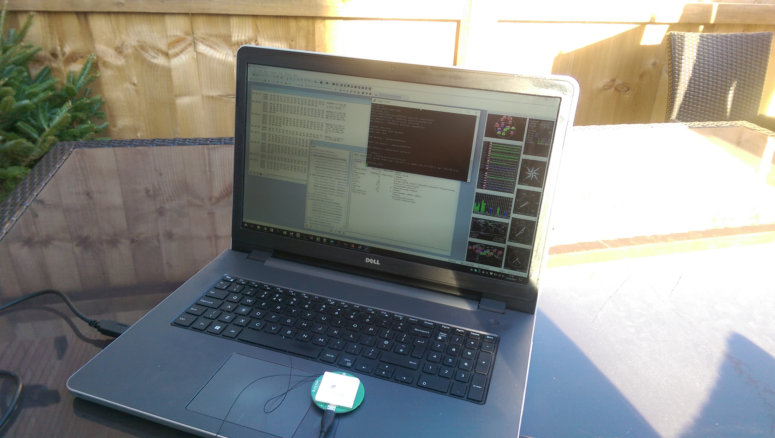

Since posting this topic, I've had another set of prototypes manufactured to fix a couple of artwork issues and also to improve GPS performance with an increased ground plane and closer-to-50R impedance trace feeding the GPS module from the antenna. These changes have pushed back the reset of the development by a couple of weeks but these are necessary adjustments resulting in a far better product.
Latest pictures of the development so far are attached.
The manufacturer incorrectly used green silkscreen rather than black as requested on this latest batch, however, they sent me some free replacement "black" boards 3 days after receiving these. Fantastic service!
Initial power on was extremely positive. Good performance from the GPS, receiving 18 satellites with a good position fix. HDOP and VDOP figures were lower (2.16 and 2.4 respectively) than the previous iteration (4.2 and 6.9 respectively) of board, providing a high level of confidence in the position achieved. The ESP32 successfully powers up and communicates over USB via an FTDI UART device however it only has the diagnostic firmware in at present, still responds to the basic commands available at 115200 baud.

- IMAG3190.jpg (768.08 KiB) Viewed 63933 times
- IMAG3189.jpg (1.84 MiB) Viewed 63933 times
- IMAG3187.jpg (2.13 MiB) Viewed 63933 times
