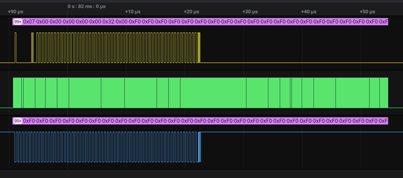

For debugging purposes, I have removed both of the actual SPI slaves from the bus, so the only thing that's connected to them is the ESP32. See the attached image for what my logic analyzer shows for this code.
For the second transaction, the driver seems to drive the chip for two more 8-bit cycles than expected. It looks like it's actually operating the transaction in half-duplex mode, although the device is configured as full-duplex. This happens only when I do the first dummy transaction - if I remove the first spi_device_transmit, the other transaction behaves as expected.

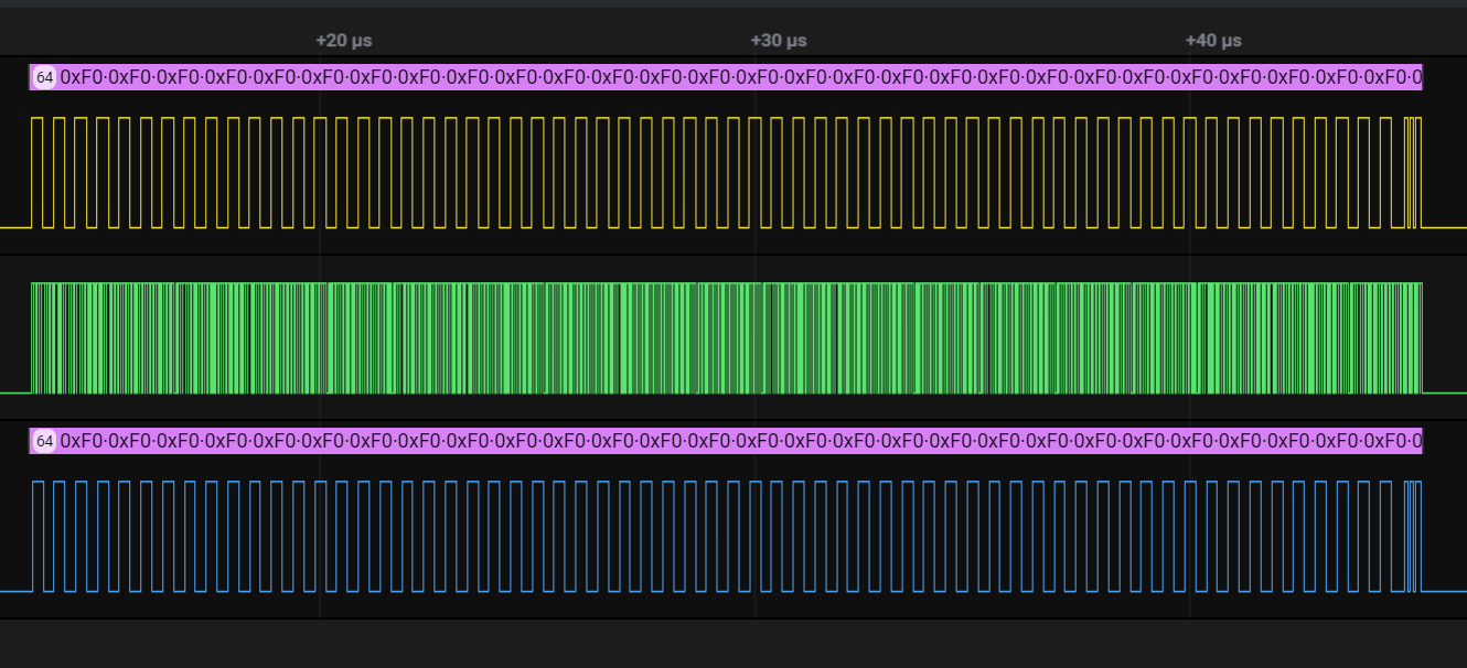

I'm having the same problem, only on esp-idf 4+, works fine in 3.3.
Transactions are working fine, but as soon as I run a transaction with the half-duplex device, everything goes to hell on the other devices. See screenshots attached.

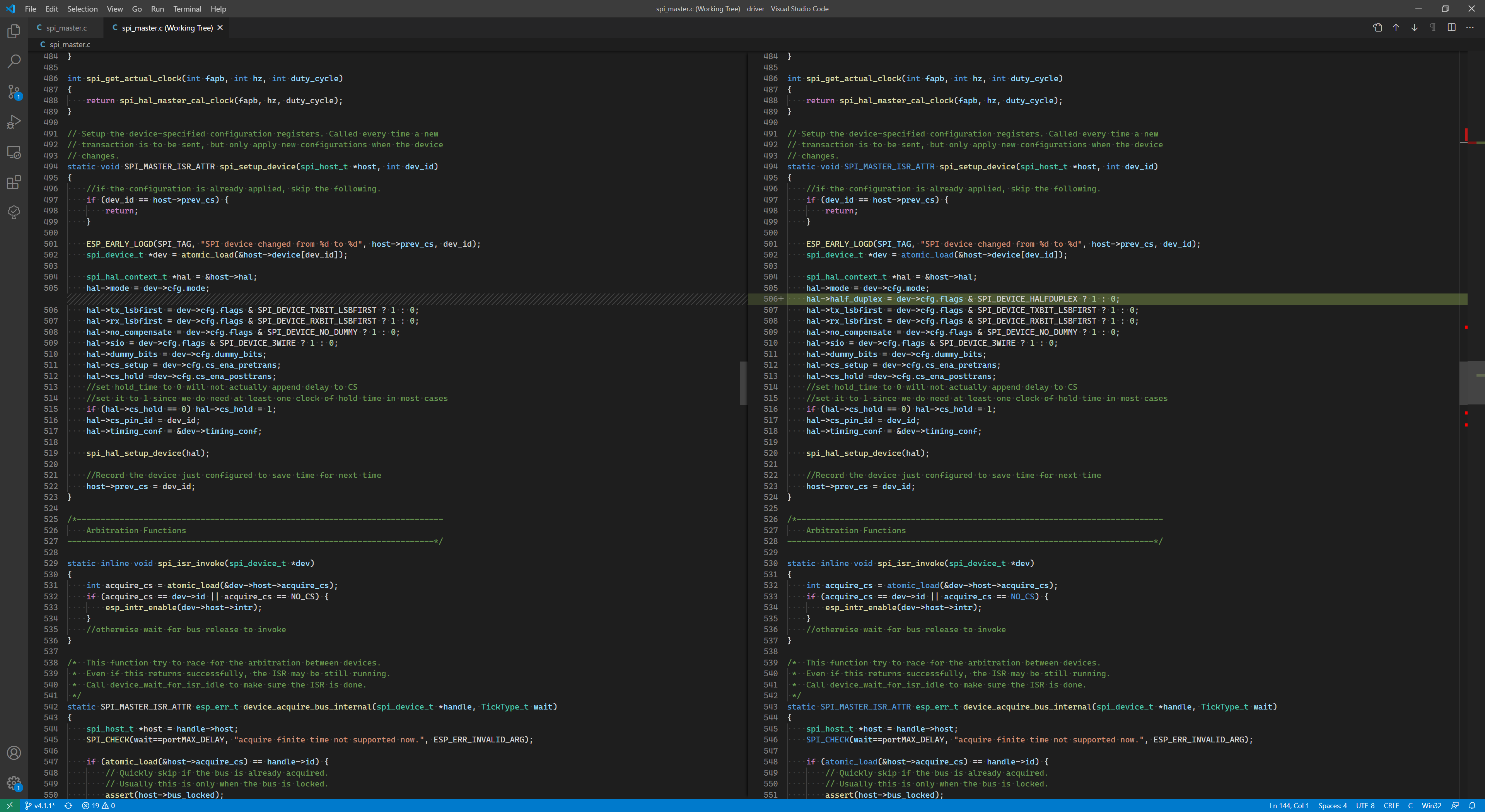

Bug fix for esp-idf 4.0, 4.1, 4.2 (code is different in 4.3):
Add line: hal->half_duplex = dev->cfg.flags & SPI_DEVICE_HALFDUPLEX ? 1 : 0;
To spi_setup_device() in components/driver/spi_master.c:
static void SPI_MASTER_ISR_ATTR spi_setup_device(spi_host_t *host, int dev_id)
//if the configuration is already applied, skip the following.
if (dev_id == host->prev_cs) {
return;
ESP_EARLY_LOGD(SPI_TAG, "SPI device changed from %d to %d", host->prev_cs, dev_id);
spi_device_t *dev = atomic_load(&host->device[dev_id]);
spi_hal_context_t *hal = &host->hal;
hal->mode = dev->cfg.mode;
hal->tx_lsbfirst = dev->cfg.flags & SPI_DEVICE_TXBIT_LSBFIRST ? 1 : 0;
hal->rx_lsbfirst = dev->cfg.flags & SPI_DEVICE_RXBIT_LSBFIRST ? 1 : 0;
hal->no_compensate = dev->cfg.flags & SPI_DEVICE_NO_DUMMY ? 1 : 0;
hal->sio = dev->cfg.flags & SPI_DEVICE_3WIRE ? 1 : 0;
hal->dummy_bits = dev->cfg.dummy_bits;
hal->cs_setup = dev->cfg.cs_ena_pretrans;
hal->cs_hold =dev->cfg.cs_ena_posttrans;
//set hold_time to 0 will not actually append delay to CS
//set it to 1 since we do need at least one clock of hold time in most cases
if (hal->cs_hold == 0) hal->cs_hold = 1;
hal->cs_pin_id = dev_id;
hal->timing_conf = &dev->timing_conf;
spi_hal_setup_device(hal);
//Record the device just configured to save time for next time
host->prev_cs = dev_id;
