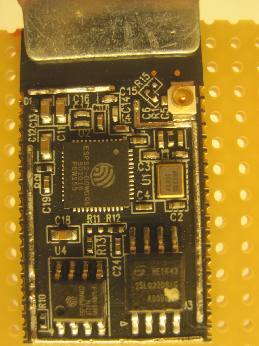

you need an ESP32-module or board that has a V1 ESP32
the wrover with mounted pSRAM, that was delivered last weeks - and 502016 product date ID have -
they all V0 ESP32 ? - this mean, that we can not use the mounted pSRAM on it?
they do not have too many items in stock,
are this spoken Wrover / ESP32 SoC Chips V1?
do you know the productions date ID on the ESP32-D0WD
that are V1 and can you write here the date ID?
Possible they made small batch rev1 in 502016. Hard to believe they would send nonfunctional psram wrover to customer. Not sure if efuse revision check for rev1 would be valid in test batch.
edit: perhabs this was not knowed to this time stamp in dez 2016 that this is nonfunctional psram modul?
i got the wrovers in may 2017 btw. and would update the wrover kit with this too,
but if they not Rev1 - this makes no sense to update wrover kit..
txs WiFive - the check with new hello world from examples show Rev0
but ok - could be that this is not valid.
just in time toolchain comes to final steps - ( 138 min ) "install final gcc compiler "
then i can test this ( not sure next hour but today - was long night )
