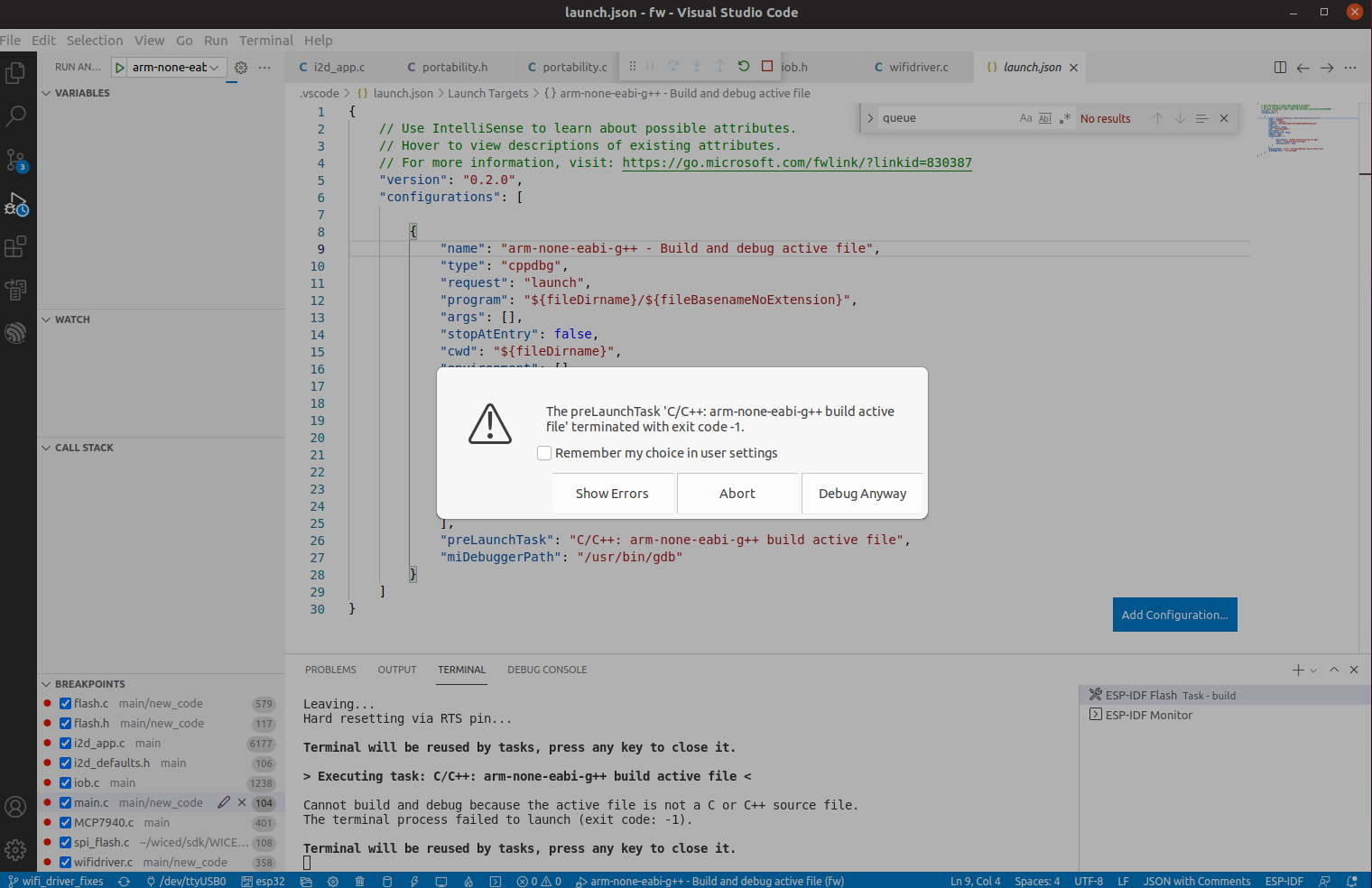

The behavior has changed -- now when I press F5, I get an error "The preLaunchTask 'C/C++: arm-none-eabi-g++ build active file' terminated with exit code -1.
Not sure what I've done to introduce this behavior...

Postby mzimmers » Tue Nov 02, 2021 9:33 pm
I'd like to return to this issue, please. When I try to start the debugger, I get this error:
Any ideas what I'm doing wrong? Thanks...
