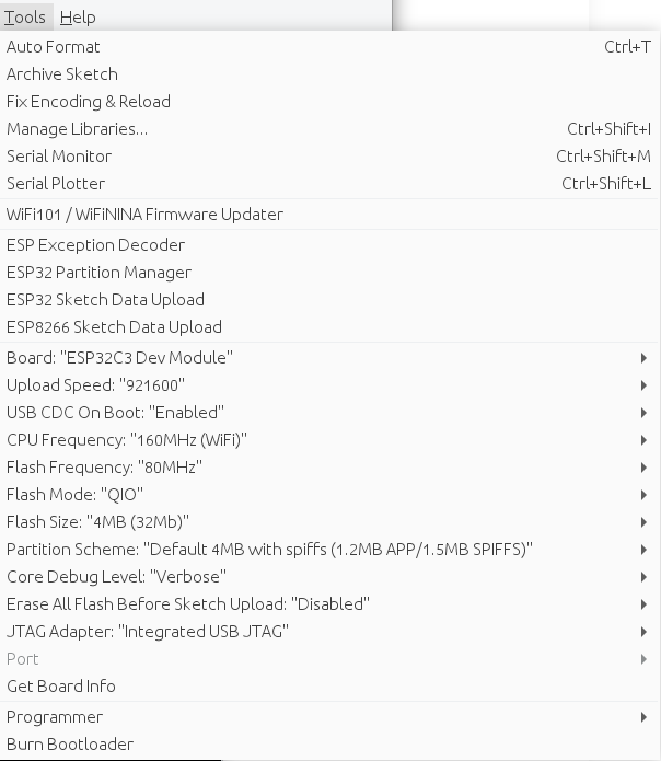

Some time ago, I bought this board (esp32 C3 SuperMini) - but I still can’t start it - it is constantly “updating” in the Windows device manager every second (I don’t know how to call it more correctly).
I'm using arduino ide for flashing. I found a sequence of steps on the Internet that could help: https://community.platformio.org/t/how- ... rmio/36042 - but it didn't help me.

Possibly you need to put the device into download mode manually for the first flash. If the board has a 'boot' button, hold that while plugging it in; if not, ground GPIO9 and plug it in.

I assume this is the sort of mini device that only has a direct USB connection. In addition to the boot button as suggested above, you will want the following settings in Arduino IDE. Note that I consider these devices very poor for developing code, since it takes ~200ms for the USB CDC connection to establish. If your device is crashing within the first few milliseconds due to a misconfigured peripheral/pin, you will not be able to see the error before the reboot loop starts.
Screenshot from 2024-03-30 20-39-15.png (58.19 KiB) Viewed 10596 times
