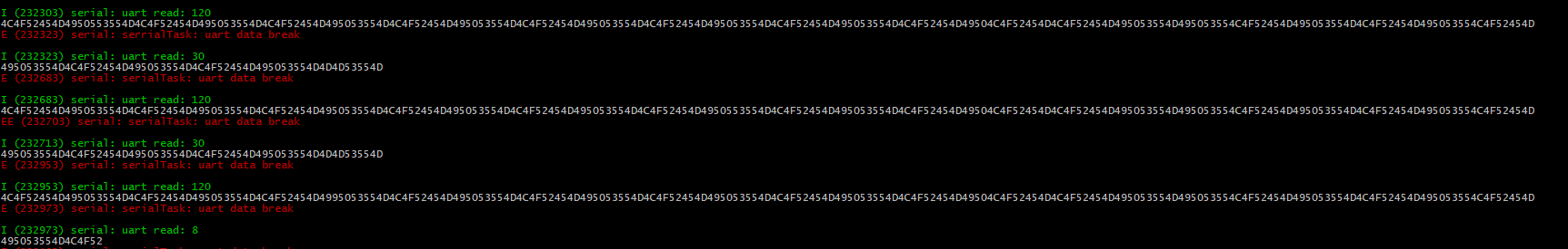

I've set up a UART communications channel using UART 1 on the ESP-WROOM32.
I've set up a thread running which constantly checks fro any UART events from the xQueueReceive() function. If the packet length being received is less or equal to 120 bytes, then no problem is encountered.
If the length of the packet being received exceeds 120 bytes, then I've met some unexpected behavior. The first part of the received packet is truncated at 120 bytes (which I've been led to believe is a hardware-defined limitation) but I'm not always receiving the rest of the message.
So, for example, if I'm being sent a 150 byte packet, I expect to receive a packet of 120 and a packet of 30 bytes. Instead, the second packet is arriving arbitrarily with some missing bytes, most of the times being truncated to 8 bytes. I've attached an example of such below, with 2 packets (120+30) being received correctly while the 3rd is cut off at the 8-byte mark.
My settings for the UART channel are as follows:
Data Bits: 8; Stop Bits: 1; Parity: Even; No HW Flow Ctrl, RX_flow_control_thresh: default
I've tried this out at different baud rates (38400 and 19200) but the same problem persists.
A posted snippet of my code can be found below. I've only copied what I believe to be the relevant section.

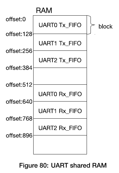

same here. According to the technical reference (pg 336), default HW buffer size is simply 128 Bytes:
UART & RAM layout
I could verify that 128 Bytes is exactly edge where everything works. According to the technical reference it is possible to reorganize it. For example when you're not using TX, you can easily gain another 128 Bytes. When using only 2 UARTs (log + custom), then in theory you can gain another 256 Bytes. I did not study it in detail yet.
Seems to me that `uart_read_bytes()` function handle some kind of buffer abstraction.
Maybe DMA can easily solve this.
Best regards
Martin
