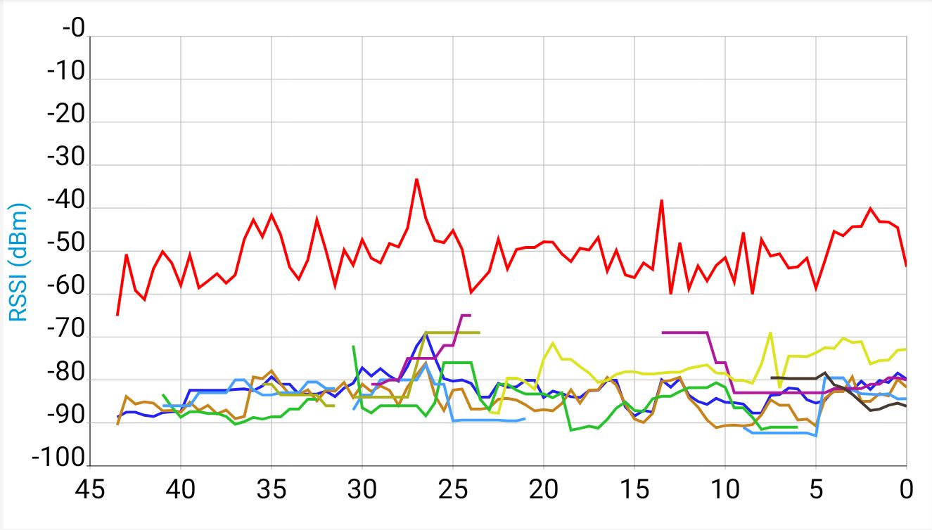

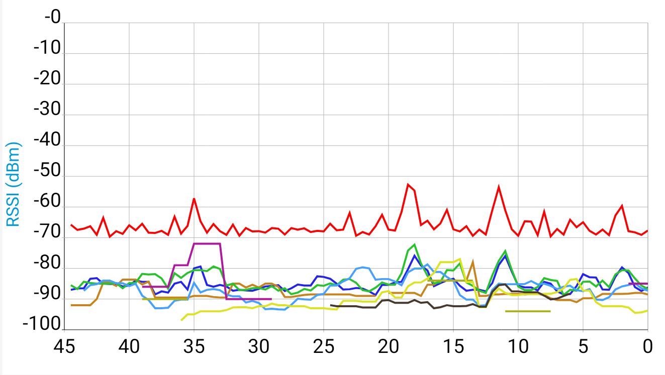

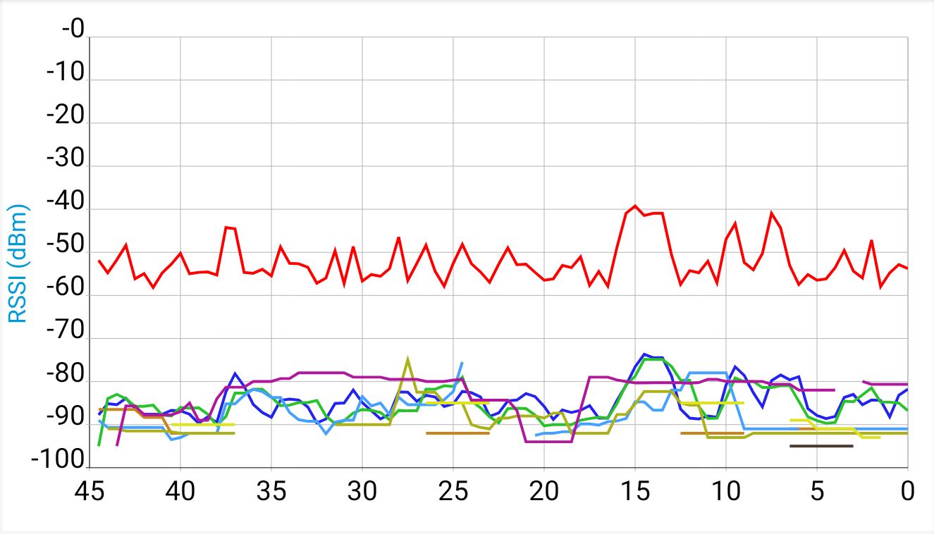

I then enabled the RSSI graph (on the nRF Connect 'scanner' screen, open the '3 dots' menu).
The image below shows RSSI at ESP_PWR_LVL_P9 (only the red trace is relevant):
The image below shows RSSI at ESP_PWR_LVL_DEFAULT:
The image below shows RSSI at ESP_PWR_LVL_N12:
Averaging the RSSI of the top image, and comparing with average RSSI of the bottom image does show a clear difference. The change from defaults to P9 appears nominal at best. The comment at the top of esp_ble_power_type_t in esp_bt.h indicates ESP_PWR_LVL_P3 (+3dBm) is used as default, if nothing has been set.
