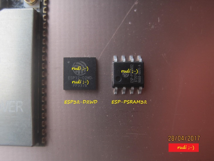

I don't have full details at the moment either, sorry - I know that's frustrating.rudi ;-) wrote:Angus, do you can tell more about the manufacturer of the used pSRAM in WROVER and where we can buy?
is there a datasheet available from this used pSRAM?
My understanding is the the WROVER module integrates our own branded PSRAM chip, ESP-PSRAM32. This chip is a SOP8 150mil package with the same pinout as the common/standard SOP8 package quad I/O SPI flash. Four megabyte capacity. I expect you'll be able to buy the ESP-PSRAM32 from us separately to the WROVER module once WROVER is available, although please email sales@espressif.com to confirm this. More details should be available at the same time that more details for the WROVER module become available.
Regarding Lyontek, if you have any contacts there or datasheet material then please forward these to me. We're happy to confirm if this chip is compatible, but need more technical information to do so.

yeap, got a small batch on last friday from each, wrover and D2WDQ5 too
( pic is signed cause there are some fail seller on the market, sry )

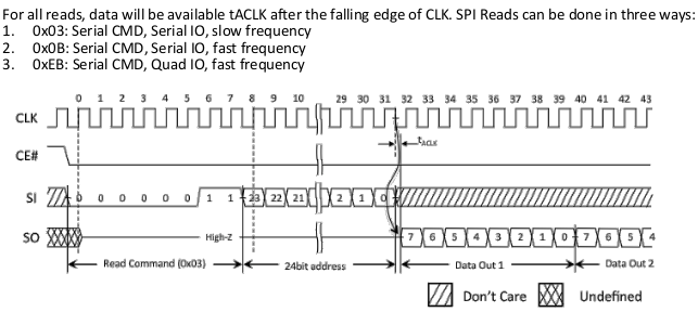

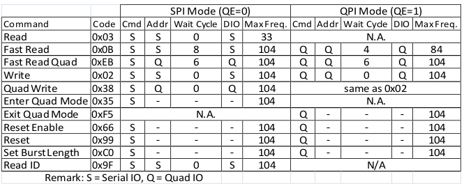

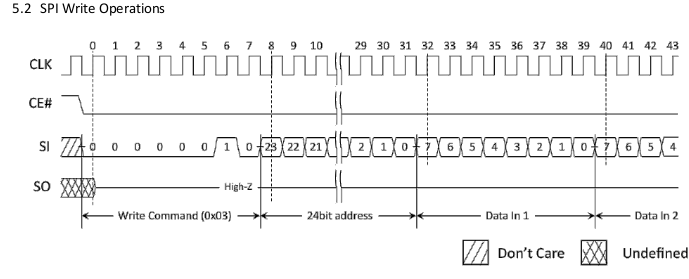

No proper datasheet yet... coming pretty soon though. It's RAM, so if any, you do not have pages as such, and you do not need to erase them; you can just write different data over them. I think I can copy/paste some data here: be warned that's not from a released or finished datasheet yet, so I don't guarantee these figures are correct.
Re: which new "esp" 8 pin ic is this on the new esp32 modul? ;-)
hi jeroen,
no 256byte/page? ok..byte-wise?
txs, this helps a lot.
perhabs you can help in the 24 bit addr, and few things like this too,
and if wrong, perhabs you can comment short:
- instructions, addresses and data are transferred MSB first, LSB last
24 bit addr means DEZ 16.777.215, we have 32MiBit means 4.194.304 Bytes
- Start: 000000h End : FFFFFFh
- each addr(pointer) has 1 Byte
- so Highest addr(pointer) is then 3FFFFF ( 400000 - 1 cause 000000h is the first byte )
future: read/write incremental support
- incremental is supported until clk work and CS not goes high
any tips if you know more, are welcome
am start next day with the things here.
thank you!
rudi
