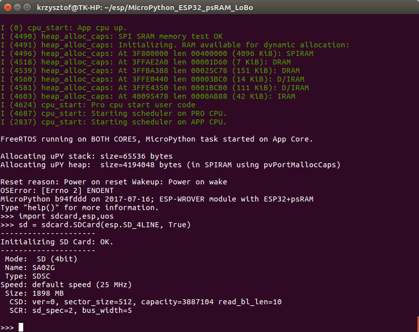

Example terminal session
rst:0x1 (POWERON_RESET),boot:0x3e (SPI_FAST_FLASH_BOOT)
configsip: 0, SPIWP:0xee
mode:DIO, clock div:2
load:0x3fff0010,len:4
load:0x3fff0014,len:5656
load:0x40078000,len:0
ho 12 tail 0 room 4
load:0x40078000,len:13220
entry 0x40078fe4
W (36) rtc_clk: Possibly invalid CONFIG_ESP32_XTAL_FREQ setting (40MHz). Detected 40 MHz.
I (59) boot: ESP-IDF ESP32_LoBo_v1.9.1-13-gfecf988-dirty 2nd stage bootloader
I (60) boot: compile time 21:07:29
I (108) boot: Enabling RNG early entropy source...
I (108) boot: SPI Speed      : 40MHz
I (108) boot: SPI Mode       : DIO
I (115) boot: SPI Flash Size : 4MB
I (128) boot: Partition Table:
I (139) boot: ## Label            Usage          Type ST Offset   Length
I (162) boot:  0 nvs              WiFi data        01 02 00009000 00006000
I (185) boot:  1 phy_init         RF data          01 01 0000f000 00001000
I (209) boot:  2 MicroPython      factory app      00 00 00010000 00270000
I (232) boot:  3 internalfs       Unknown data     01 81 00280000 00140000
I (255) boot: End of partition table
I (268) esp_image: segment 0: paddr=0x00010020 vaddr=0x3f400020 size=0x48a74 (297588) map
I (613) esp_image: segment 1: paddr=0x00058a9c vaddr=0x3ffb0000 size=0x07574 ( 30068) load
I (650) esp_image: segment 2: paddr=0x00060018 vaddr=0x400d0018 size=0xc83f4 (820212) map
0x400d0018: _stext at ??:?
I (1525) esp_image: segment 3: paddr=0x00128414 vaddr=0x3ffb7574 size=0x052d0 ( 21200) load
I (1551) esp_image: segment 4: paddr=0x0012d6ec vaddr=0x40080000 size=0x00400 (  1024) load
0x40080000: _iram_start at /home/LoBo2_Razno/ESP32/MicroPython/MicroPython_ESP32_psRAM_LoBo/Tools/esp-idf/components/freertos/./xtensa_vectors.S:1675
I (1553) esp_image: segment 5: paddr=0x0012daf4 vaddr=0x40080400 size=0x1a744 (108356) load
I (1711) esp_image: segment 6: paddr=0x00148240 vaddr=0x400c0000 size=0x0006c (   108) load
I (1712) esp_image: segment 7: paddr=0x001482b4 vaddr=0x50000000 size=0x00400 (  1024) load
I (1794) boot: Loaded app from partition at offset 0x10000
I (1794) boot: Disabling RNG early entropy source...
I (1800) spiram: SPI RAM mode: flash 40m sram 40m
I (1812) spiram: PSRAM initialized, cache is in low/high (2-core) mode.
I (1834) cpu_start: Pro cpu up.
I (1846) cpu_start: Starting app cpu, entry point is 0x400814e4
0x400814e4: call_start_cpu1 at /home/LoBo2_Razno/ESP32/MicroPython/MicroPython_ESP32_psRAM_LoBo/Tools/esp-idf/components/esp32/./cpu_start.c:219
I (0) cpu_start: App cpu up.
I (4612) spiram: SPI SRAM memory test OK
I (4614) heap_init: Initializing. RAM available for dynamic allocation:
I (4615) heap_init: At 3FFAE2A0 len 00001D60 (7 KiB): DRAM

krzychb
Posts: 428
Contact:
Re: MicroPython on ESP-WROVER with 4MB of psRAM
Postby krzychb » Sun Jul 16, 2017 5:01 pm
Hi @loboris,
This is really impressive!
In not time at all I was able to build, upload, run and test MicroPython :D
Taken the application support for psRAM and the ESP-WROVER-KIT with 4MB of psRAM have been just recently released, this is really remarkable.
Congratulations!
MicroPython deployment by loboris running on
Screenshot from 2017-07-16 18-40-21.png (135.84 KiB) Viewed 43367 times
