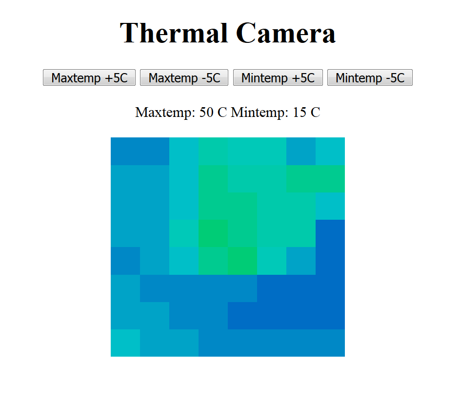

Hello together, I´m new in this forum, actually that´s the first time I post anything in a forum, so if I do something wrong (wrong forum, wrong topic, etc. forgot information) please tell me.
I am working with an ESP32 Feather from Adafruit in combination with an AMG8833 Feather from Adafruit.
https://www.adafruit.com/product/3405
https://www.adafruit.com/product/3622
I´m trying so set up a webpage where I can see the live stream of the thermal cam an also can adjust the Minimum and Maximum Temperature.
So far I can view the Picture via the manipulation of a table and I can also adjust the Min/Max temperature.
Now I cannot figure out how so set up the video stream, I have to say I´m an absolute newbie in Networking. I tried to set up a java script to update the cells of the table but that didn´t work out. I also googled but I can´t find anything similar. Do I have to use Websockets and have an extra Html file on my computer which is the client and one provide an Websocket server on the ESP32 or can I run everything on the ESP32 an use the provided array somehow as an source for an HTML video element?
I´m really stuck here and would appreciate any help.
An image of my actual homepage is in the attachements.

There are multiple approaches that work here. Seeing that you only have 8x8 data, I'd say you were on the right track. You can keep the ESP32 webserver which serves the HTML file and the controls to increase and decrease the temperature, but add a websockets server to stream the actual data of the sensor. Add in some javascript to connect to the websocket and dynamically update the cells and you should be there.

Let start from beginning, you posted in esp-idf topic that suppose to be in arduino part of forum, assuming you want to continue with code you pasted here.

I've got the beginning of a web capture/stream here: https://github.com/RobotHacker/CameraWebServerThermal

I made a table based websocket streaming app based on the code and ideas in this thread: https://github.com/RobotHacker/WebBasedThermalCamera
